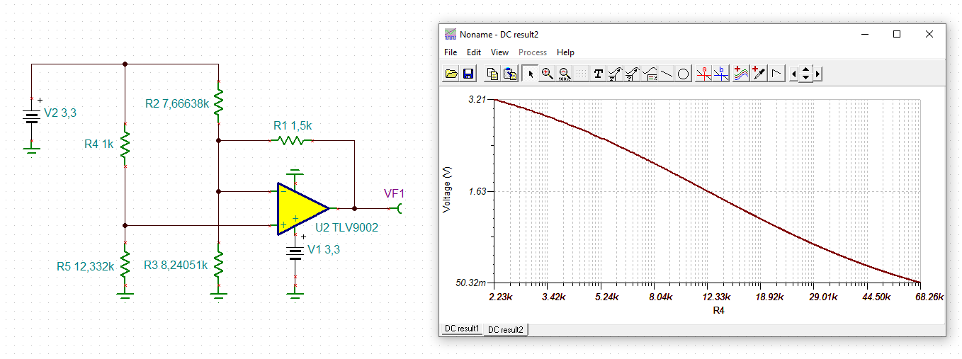

Hello Team,
I want to design a temperature measuring system using TLV9002SIYCKR.
The following is the circuit designed.
The NTC temperature sensor used is NTCLE350E4103FLB0.
The required temperature meaning range is -20°C to 70°C.
The resistance of NTC at -20°C is 68. 259K and the resistance at 7068259.59 is 2.27K
The gain seems to be varying as the NTC resistance is carried in the simulation.
My required output is in the range of 50mV to 3.205V for the temperature range from -20°C. to 70°C.
If I adjust the output voltage span can I solve the gain issue?
