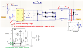

The issue is that 4-20mA current output value is drifted from 4mA to 6mA on the 0 value pressure. We have checked input voltage is same but output current is drifted by default.
Under what CS condition (frequency range) that the current loop is drifting under test. Below is the reference tested under IEC 61000-4-6 in XTR117, which is similar to XTR115/XTR116 2-wire transmitter.
Please check out the markings below. Place series of low ESR bypass capacitors across Vsup if the circuit failed CS tests.

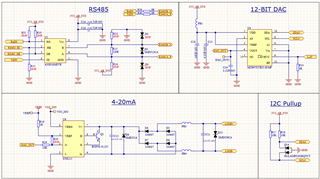

Hi Raymond,
MCU is operated on +3.3V. So we can not use Vreg +5V supply.
We have one question. What is use of R7-250ohm in simulation circuit?
Actually we have check Pin#3 Iret connected with GND. That is not float in any eval board.

Hi Kai,
We shared Interfacing circuit between 4-20mA transmitter to DAC. I think this is help to understand 4-20mA circuit section.
-> 12-Bit I2C based DAC is used for XTR115 chip analog input. External DAC is operated on +3.3V.
Darshan
As Kai suggested, you should present the entire schematic in XTR115. XTR115 has 2.5Vref and 5Vref pins, and it does not provide 3.3V reference voltage. It is not clear what you have.
Are you doing 4-20mA current loop with 0-3.3V input voltage? From the presented XTR115 schematic, the input resistor values are not quite correct either, even 3.3Vin supply is used.
Shared interfacing circuit between 4-20mA transmitter to DAC.
We have tested this circuit and it is working stable. So we need suggestion regarding the CS test. If input resister effected in the CS test then you should suggest me. Other then please provide me the CS test suggestions.

Hi Darshan,
take care, the Iret pin of XTR115/7 is no signal ground! You must allow this pin to freely float. Don't connect it to signal ground:
Also note, that every current flowing into the Iret pin must be sourced by Vreg or Vref!!!! If you have any other supply voltage driving some input circuitry, you will need to add galvanic isolation. See again figure 3 of datasheet.
Kai
Hi Darshan,
This is proper connection for XTR115/XTR116/XTR117 2-wire 4-20mA transmitter. Please note the GND connection and Floating_GND node, which are not the same ground. In addition, the DAC8551's supply voltage in the reference design is powered by XTR116 IC, not MCU.
I am enclosing series application notes and videos in 2-wire and 3-wire 4-20mA transmitters and its application. Per your design approach, 3-wire XTR111 4-20mA transmitter may be used.

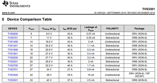

BTW, TI also makes great TVS as well. The latest designed TVS, part numbers shown below will outperform some of recommended TVS in our old reference design. Enclosed are some of the datasheet, application notes for your references.
https://www.ti.com/lit/an/slvae53/slvae53.pdf?ts=1661461759768
