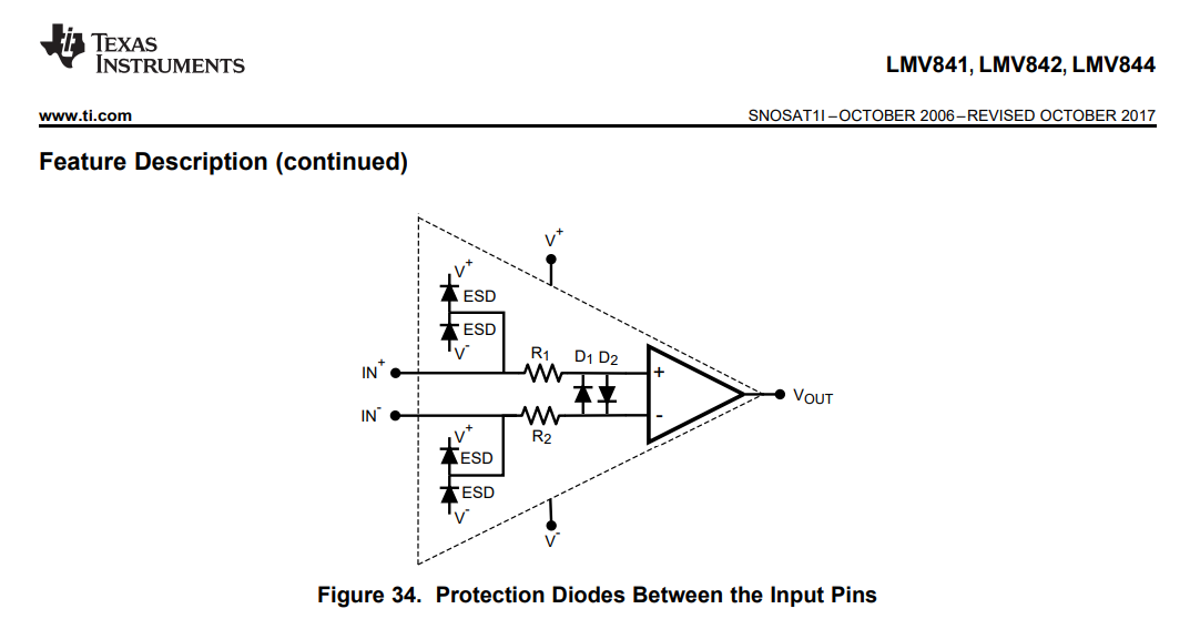

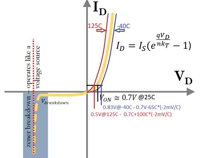

The input resistance of any op amp, including LMV844, cannot be measured unpowered because by doing so all you measure is the impedance of the input protection diodes - see below. Since the forward bias voltage of the diodes decreases roughly -2mV per degree C, it will look in your test like the input resistance decreases with increase temperature.
The actual input common-mode input resistance of LMV844 can be calculated from the graph of IB vs Vcm and it turns out to be 80TΩ at 25C and 533Gohm at 85C - see below.

Thanks for your warm support, it's very detail, could you pls help me mark which protection diode it is? Is there a curve of diode forward voltage versus temperature? And could you please combine the test method of the multimeter and talk about why the measured impedance will decrease as the forward voltage of the diode decreases? thanks alot.
All diodes shown in Fig 34 are input protection diodes: D1 and D2 for overvoltage protection while remaining four are ESD protection (see label).
Below please see the typical diode forward bias voltage vs temperature.
What your customer does using multimeter has nothing to do with the input impedance of the op amp - all they do is to test forward (or reverse bias) resistance of the input protection diode - this is meaningless.

Thanks for your answer, There are still some confusion is if IN- to V-, what should be the reverse voltage drop for ESD? why is8V/15pA? should be 8V/10pA? Δvalue?
Hangjie,
I hope you understand that all our discussion of the input resistance of forward or reverse bias input protection diodes under unpowered conditions has nothing to do with the actual input resistance specified in the data-sheet since the latter is based on a reverse bias leakage of ESD diodes under powered condition. As far as Rin_cm at 85C goes, it should in fact be 800GΩ.
