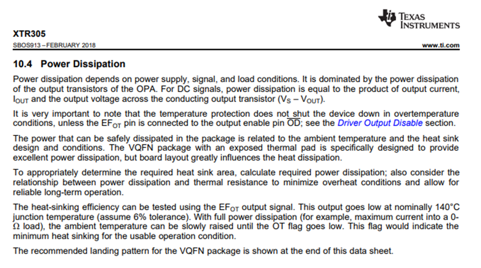

    Is the XTR305 (U3) or one of the regulators causing the board to heat?

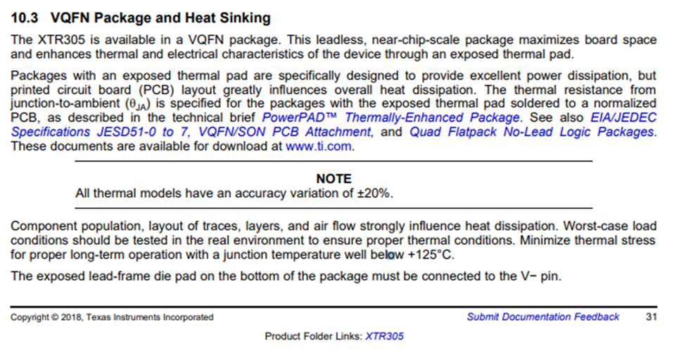

    The XTR305 PowerPAD needs to be connected to a power plane capable of removing heat from the IC.  The thermal impedance specifications for the XTR300 are based on a PCB layout that properly removes heat from the XTR305 PowerPAD.  On the XTR305, depending on the load condition and current output of the XTR305, the device is expected to dissipate power.   As an example, while sourcing 20mA output current with small load resistance of 100-Ohm, the voltage at the XTR305 output is around 100-Ohms*20mA= +2V.  Therefore, the power dissipated by the XTR305, in this particular example would be as high as (+VS -  Vout)*Iout = (+15V – 2V)*20mA= ~260mW.
    Information on this topic is provided at the end of the XTR305 product datasheet.  I've copied some of the information below.
    Similar layout guidelines should apply to the voltage regulators to dissipate heat.
    Thank you and Regards,
    Luis

  • Dear Luis,
    I check the design again and thank you for your hint.
    In the first version of board, we make a mistake and connect the Power-Pad to GND.
    So we change this from GND to V-.
    :-D
    Now the V- power pad is an inner layer of our 4-Layer PCB. So now this clear. The heat cannot move away from the XTR305. I will do the new design work and I think that this will resolved my issue.
