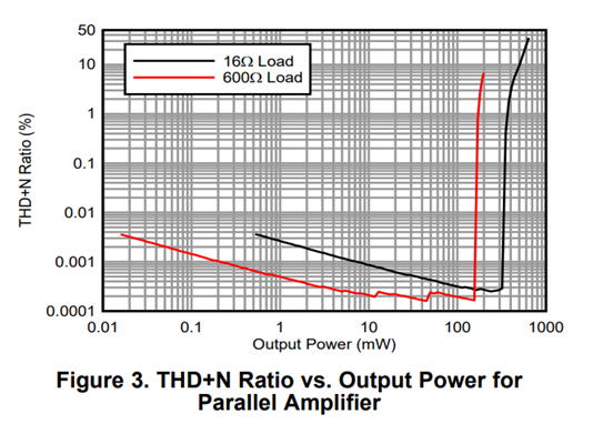

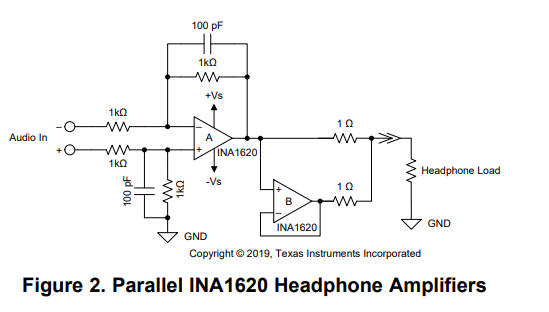

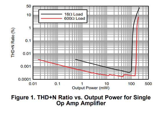

I see on the datasheet page 9 that the performance of this chip really suffers if the output amplitude is over 1Vrms.  To drive certain aviation headsets to necessary high output levels (they stick earplugs in their ears) I need much higher Vpp.  What happens when two chips are paralleled like often suggested by audio enthusiasts?  Does this allow higher Vpp at lower distortion or just higher current at lower Vpp?  The BUF634A also shows this behavior, beyond 10Vpp.
