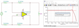

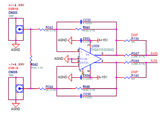

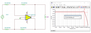

In the process of using THS4131, we found that if the feedback capacitor is 4.7nF and a DC input is provided at this time, an oscillation of 280/320MHz will be generated at the output end.The oscillation frequency is related to the positive and negative input, and the oscillation amplitude is related to the input amplitude.
I tried disconnecting the load, but it didn't solve the problem, reducing the feedback capacitor to 470pF the oscillation still exists, but if it is reduced to 100pF, the oscillation disappears.

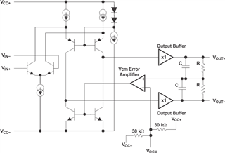

In my experience, adding feedback capacitance to a CFA can cause oscillations, but according to the data sheet this is not a CFA. It seems to me that adding a feedback capacitor to the VFA improves the phase margin, but here it causes oscillation, which is very confusing to me. Looking forward to your reply.
