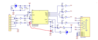

    (2) the user guide show that  the ground of the INA239evm should be connected to the ground of the system under test.
    if the  bus voltage of the system under test is very high, can i use IN- and IN+ to test small current, because the common mode voltage it can withstand is 85v. as below ,  can i connect the IN- to the ground of the EVM, i want to know this question for your point and suggestions.
    Best Regards
    yibo zhao
  • Hello Zhao,
    Here are my responses to your questions.
    (1) The datasheet does not associate the conversion time with a specific number of samples from the ADC. This is partly because it is not a set number of samples, but samples over a set amount of time.  The exact number of samples could vary slightly based on variances in the ADC sample frequency. This is all handled internally.
    (2) Yes, this device can be used on the low side. Generally, if your BUS voltage is 85V or lower, then you may want to measure High side so you don't affect the load GND. Here is a video that explains some design considerations when choosing between high and low side: https://training.ti.com/ti-precision-labs-current-sense-amplifiers-design-considerations
