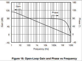

I have a customer that wants to check if the OPA4171 is unity-gain stable. From looking at the datasheet and some quick “unity-gain stable” definitions, it looks like it might be as there’s only one pole in the open-loop gain and the gain hits 0 db at the first pole. Is this correct?

    The OPA4171 is unity-gain stable, and you are close with your analysis. Your first pole is the dominant pole at low frequency, which begins your 20dB/decade dropoff, your second pole is after your 0dB crossing, which you can see with your phase starting to dropoff at the end of the Aol graph.

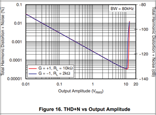

    Another good thing to look for if the device doesn't specify unity gain stability in the datasheet is look for a "minimum stable gain" in the electrical characteristics table. If they don't list one, it can help point to unity-gain stability. Another place to look is in the test conditions in the EC table or typical characteristics charts. THD+N is measured at unity gain, which you would not do if the amplifier is unstable.

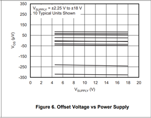

    I see the customer has the supply voltage as 3.3V. Please note in the EC table some of the specifications have a minimum voltage of 4V, so you may see reduced performance at lower supply voltages. (some examples below)
