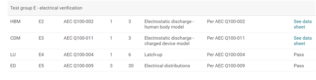

Could you kindly share us the ESD report of INA186-Q1?
Also could you share the ESD test setup or which test condition standard should we refer?

Hey Frank,
Here are the ESD and other related quality tests from INA186-Q1, found in the product's qualification summary:
Here is where I found where TI explains where AEC Q100 tests come from.
https://www.ti.com/support-quality/faqs/qualification-summary-faqs.html
Here is the website of the link containing all AEC Q100 documents:
http://www.aecouncil.com/AECDocuments.html
Hope this helps.
