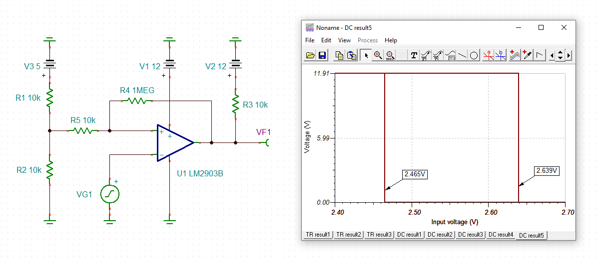

I am using LM2903 Comparator with hysteresis in my circuit. Circuit is as shown below image. I want to know the formula to calculate the Hysteresis (Both High Threshold & Low Threshold) for the circuit shown (i.e inverterting compartors) and also for similar configuration with non-inverting comparator.
