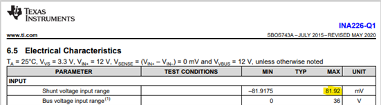

What is the Shunt input range of INA226-Q1?
Similar to the following picture of INA226:
In addition, when the customer +BATT=9V,
The voltage difference of IN+IN- SHUNT INPUT range is: 0.142V min 0.144V typ 0.145V max what will happen?

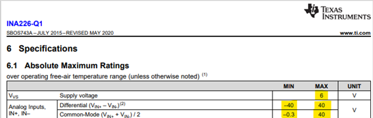

    The INA226-Q1 needs to be powered by less than 6V to eliminate risk of damaging the device, connecting 9V to the Vs pin will damage the INA226.
    The Differential (IN+ - IN-) voltage needs to be kept between -40 to 40 volts and the absolute voltage must be between -0.3 to 40 volts to avoid damage, so there will be no risk of damage from applying 142-145mV to the pins.
    The differential input range is -81.9175mV to 81.92mV, so the voltage range you are considering (142-145mV) will be out of range for the device and you will not be able to make meaningful measurements.
