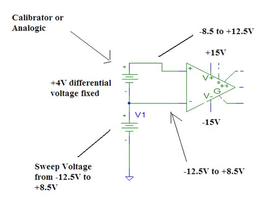

  • Hi Rahul,
    I have tried to reproduce the problem using the test conditions described on the post and the output VOP-VON is still stable at 0.5V.  I also performed different combinations where I performed a sweep of the input common-mode voltage while holding the differential voltage constant at 4V. Provided that both positive and negative inputs where inside the input voltage range; the reading was stable.
    I was able to obtain unstable readings only if I left the 4V differential signal floating; where readings were fluctuating, obtaining a similar behaviour as you described (sometimes).  If I forced on purpose INN << -12.50V with respect to AGND; or  INP>>12.5V putting the device outside of range;  I obtained unstable readings. (about ~0.640V for the INN=-14.5V case.
    It may be possible that in the set-up a ground loop may be formed; where one of the supplies is not at the expected voltage.  Please see ADCPro plots below.
    If you can provide a diagram/schematic of how the supplies are being connected; and/or DC coupled oscilloscope plots of the input signal (both negative input and positive input) with respect to AGND this could help.
    Luis
    VOP-VON plot; G=1/8; INP1 - INN1 = 4V; INN = -12.5V to 8.5V with respect to AGND; Readings Stable
    VOP-VON plot; G=1/8; INP1 - INN1 = 4V; INN = -14.5 with respect to AGND;Measurement unstable(outside input range)

  • Hi Rahul,
    Thank you for looking into this and providing the voltage supply information.  When designers work with linear amplifiers such as instrumentation amplifiers, op-amps, digital programmable gain amplifiers, and difference amplifiers, they must always consider both the differential input voltage range, and the common-mode range or input voltage range of the signal input source with respect to the supplies of the amplifier. This is not always an easy or trivial problem.  Instrumentation amplifiers have generally an input voltage range requirement with respect to their supplies.  Other amplifiers, such as difference amplifiers may have a common-mode range signal requirement that can be above their supplies; for example the INA117 has a common-mode voltage range of +/-200V that can be above its voltage supplies +/-15V.
    Some amplifiers specify this input voltage range in terms of the common-mode voltage, where common mode voltage is the average voltage of the inputs (INN+INP)/2. In the case of the PGA280, the input voltage range is simply specified as the input voltage with respect to its input supplies.  In the PGA280 is required that both inputs voltage potential are inside the range:
    (VSN) + 2.5V < INPUT Voltage < (VSP)-2.5V; where the Input Voltage is the voltage of IN+ input or the IN- input with respect to the VSN and VSP supplies.
    In our case, the voltage supplies are VSN =-15V; and VSP=+15V. Therefore the input range limits are:  -12.5V < INPUT Voltage <+12.5V.  Let's say for example, INN=-15V and INP=-11 giving 4V differential.  This voltage is outside the linear range of the device since INN is outside the -12.5 voltage limit above.  Another example, INN= 3V and INP = 7V; the differential voltage is still 4V but this time both inputs are inside the linear range of the amplifier.
    One classical application of instrumentation amplifiers is to connect a sensor; such as a thermocouple to an instrumentation amplifier.  The thermocouple provides a differential signal that will vary a few +/- ~100 mV in range.  The user must set or fix the input voltage of this thermocouple in the linear region of the Instrumentation amplifier. I borrowed the following section from the PGA204 datasheet which is a different instrumentation amplifier device; with a different set of common-mode requirements, however the concept of common-mode voltage is still valid.  Please see example of different sensors with different circuit setting the common mode below.
    These circuits above have a well defined potential with respect to the voltage supplies of the instrumentation amplifier.  Note: The differential signal does not have to be directly connected to GND; however it must have a well defined potential with respect to the instrumentation amplifier supplies. For example, in the thermocouple circuit above, you could have the thermocouple's 10Kohm resistor connected to +3V with respect to AGND and be in the linear range; since both inputs of the PGA still are inside linear region; the thermocouple provides a differential signal of +/-`100mV...
    In your example, the calibrator is providing a fixed 4V differential between INN and INP; however, if the user only connects this differential voltage and does not provide a way to define the input voltage with respect to the  to the VSN and VSP supplies;  the 4V differential voltage will "drift" freely or "float" between the input analog supplies  VSP and VSN; and most likely in this case the signal can drift such one of the inputs its only being held by the internal protective clamp (ESD diode) of the instrumentation amplifier. When this happens the amplifier is already outside of its linear region.
    In any application, it is essential for the designer to know in advance the expected common-mode voltage of the input signal source generating the differential signal or provide a circuit that will establish the input voltage with respect to the input analog supplies.  I understand you have already mentioned that in your application your signal does not share a GND point with respect to the PGA, however, it is necessary to understand how much above or below this voltage is to be expected with respect to the amplifier supplies in order to select the appropiate device/solution.
    In our case, I tested the PGA280 with the following circuit:
    This circuit provides a well defined voltage for the inputs of the amplifier with respect to its VSN and VSP supplies.
    Hope this helps,
    Luis
