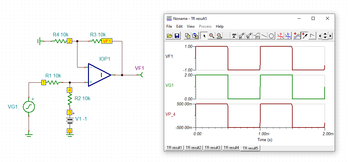

I am trying to shift 0-2V rectangular Signal to a biphasic -1V, +1V one. How can I do that?

Hi Daniel,
like this?
Or with an additional voltage follower at the input to isolate the source from the negative auxiliary voltage "V1".
Kai
Hey Kai,
Exactly like this I was trying it with that approach but I was stuck yesterday. This helped me a lot. (:
Thank you very much.
