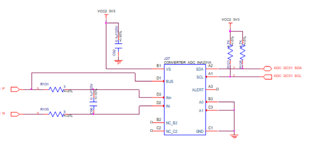

  • INA231 was used to test Vbus and Vsense, and Rsense was selected as one of 5mohm, 10mohm and 100mohm。The schematic diagram is shown below。Vs=3.3V, MUC obtains Vbus&Vsense data in ADC register through IIC.We tried to measure the instantaneous voltage of Vs at the beginning of power supply. The maximum voltage read by oscilloscope is about 3.9V, conforming to the range of 2.7V to 5.5V specified in the Datasheet.We also tried to input 4V voltage through the left side of R131, the voltage source and ina231 common ground.Unfortunately, the Bus voltage was readed by MCU through ADC was still 81.9V.As I described earlier, ina231 suddenly broke during use. I tried several methods but could not locate the problem
    What are you doing with the IN- pin of the INA? Is the shunt connected when applying 4V to the IN+ pin?

  • What are you doing with the IN- pin of the INA?   -----------To Connenting GND
    Is the shunt connected when applying 4V to the IN+ pin? --------------NO

    the main reason why a INA231 becomes damaged is that an input signal violates the absolute maximum ratings: The input pins -simulataneously or individually- must not go below -0.3V or above +30V. This can easily happen when the input lines are too long and wiring inductances cause inductive kickbacks. Of course, any other inductance intendedly or unwantedly added at the wrong place can cause destroying inductive kickbacks. Sometimes people mount a choke between the signal ground of INA231 and the shunt ground or power ground to isolate the grounds in the hope to make the circuit more immune against EMI. Never do this! There must always be a very short and very low impedant connection between the signal ground of INA231 and the shunt ground or power ground.
    Can you tell more about your application? Is any cabling involved at the inputs of INA231? Can you show a schematic?

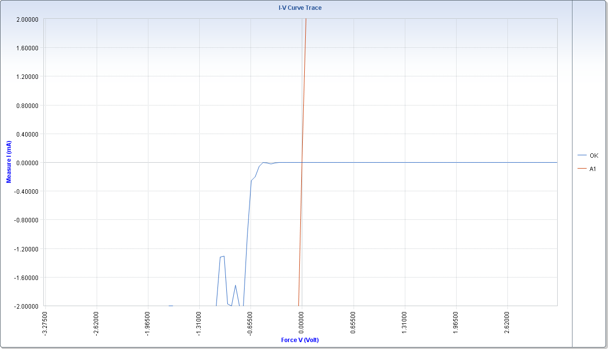

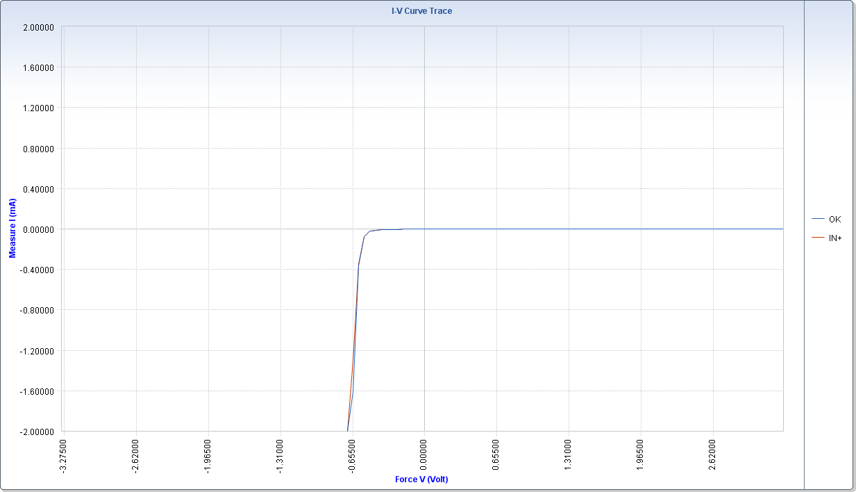

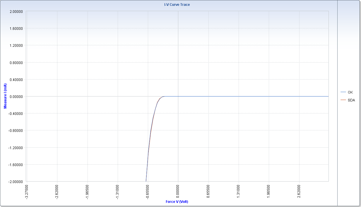

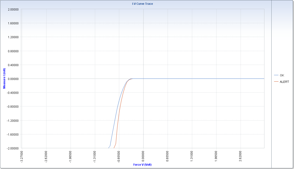

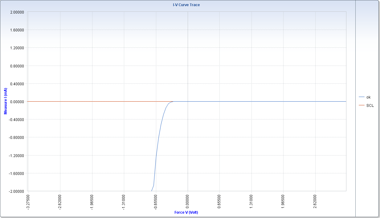

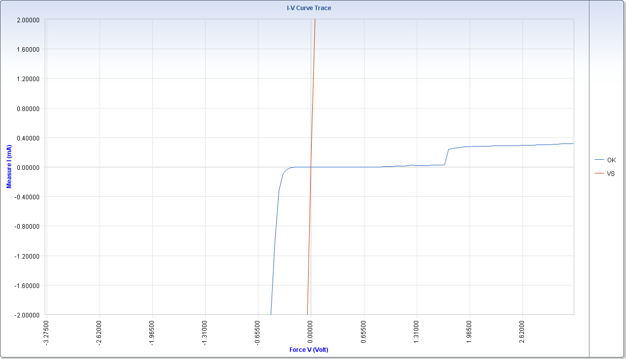

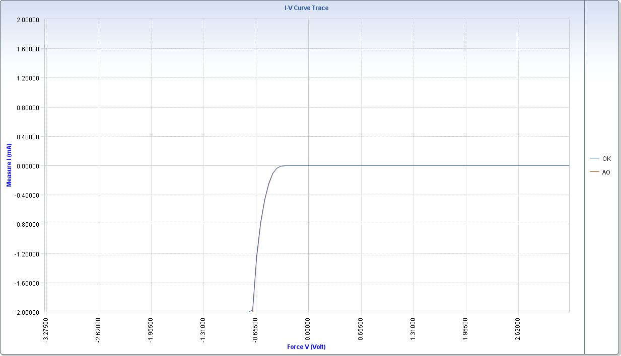

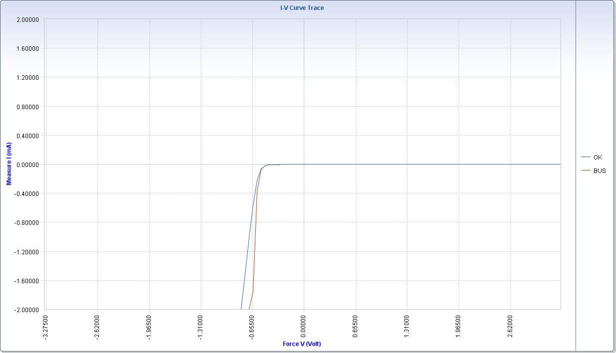

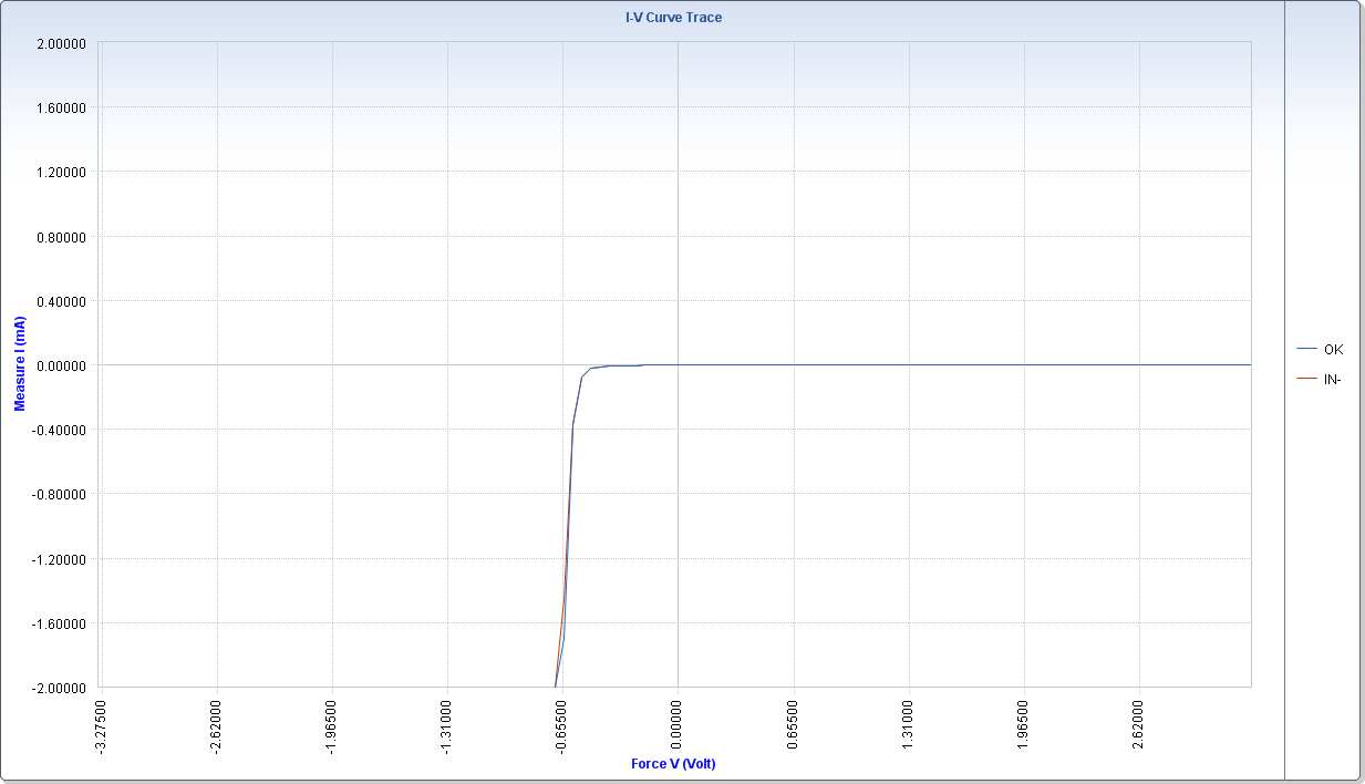

  • Hello, I've been busy lately, so no updates. As for the schematic diagram and PCB, I am sorry that I cannot provide them due to the company's confidentiality regulations. Today, we tried a new method to test INA231. We tested the leakage current of each pin by applying a voltage of 3.3V to each pin of INA231. The test results are shown in the picture. The blue "OK" line represents a good chip, and the red line represents an 81.9V chip in the test.From the graph, the three pins of VS, A1 and SCL should be problematic,but I don't know what causes this phenomenon. Please review these reports and help analyze what causes the damage of ina231. Thank you very much.
    I will look into this in the mean time I will send you a private message with my email.
