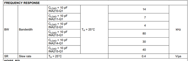

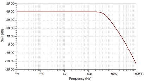

    Another question is how to calculate the bandwidth in their case?
    The cutoff frequency of the RC filter will be much higher (at around 160kHz) than that of the device, so the frequency response will be almost unchanged from what is shown in the datasheet:
    This can also be simulated:
    The -3Db frequency here is located at approximately 47kHz.
