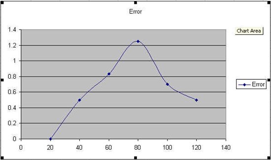

  • Hello Ganesh,
    Thank you for your schematic and the results.
    JayantD had originally brought up an issue where the output of the XTR105 was varying enough to produce up to 30degrees of temperature error when back-calculating the temperature.  For a 0-200 degree 4-20mA output application, this would correspond to: ((0.02 - 0.004)/200)*30 = 2.4mA of output variation at any time.  The data you've provided shows a changing error with temperature, but does not describe the same symptoms that JayantD described.  Are you experiencing the same variation as Jayant on the output of the XTR?
    Otherwise, I've plotted the error of your circuit output below.  Although it is not as parabolic like a standard RTD error, it does have a similar shape making me question the correctness of the Rlin1, Rlin2, and Rg resistor choices.
    In a 3-wire RTD application with a 0-200C desired temperature range, the correct values for Rz, Rlin1, Rlin2, and Rg are:
    Rz:  100
    Rg:  158
    Rlin1: 16200
    Rlin2:  18700
    Your schematic indicates the following values:
    Rz:  100
    Rg:  500Ohm potentiometer
    Rlin1: 24000
    Rlin2:  22000
    Is this design meant for a 0-200degree RTD temperature range?  If so, please try your measurements again with the values above.  If not, please provide the following information:
    Minimum Temperature
    Maximum Temperature
    Measured Value of the Rg potentiometer (Tuned in value is not on the schematic)
    I will double check your component selection based on the information above.  Also, why use a potentiometer for the Rg resistor?  Were you not able to find a close enough standard value or are you trying to trim the error down with the potentiometer?  If it is the latter then beware that the value of the Rlin2 resistor depends on the value of Rg and if you change Rg you will have to make a corresponding change to Rlin2 or you will experience unwanted non linearity errors.
    Please provide some insight into the questions raised in this post and we will get this worked out.
    Thanks and Regards,
    Collin Wells
    Precision Linear

  • Hello Ganesh,
    Thank you for helping me understand how the data was collected.  We can work on the issue Jayant brought up after we finish reducing the errors you're experiencing with a controlled input from the Fluke Calibrator.
    I believe the majority of the errors you're experiencing are a result of incorrect values for Rz, Rlin1, Rlin2, and Rg.  The correct values for all three of these components enable the linearization engine in the XTR105 to correctly achieve the 40:1 improvement over a nonlinearized RTD.  All three values must be set based on the temperature range to achieve the proper results.
    For a desired RTD temperature range of 0-200C, the correct values for Rz, Rlin1, Rlin2, and Rg can be seen in Table 1 on page 8 of the XTR105 datasheet and are listed below:
    Rz:  100
    Rg:  158
    Rlin1: 16200
    Rlin2:  18700
    Rz:  100
    Rlin1: 24000
    Rlin2:  22000
    Your values are incorrect and need to be changed.  Please change your resistor values to the values listed above and re-take your measurements.
    Let me know the results and then we will work on the noise issue Jayant described.
    Thanks and Regards,
    Collin Wells
    Precision Linear

  • Hello Jayant,
    Thank you very much for the updated information and system specifications.
    Ganesh's most recent measurements seem consistent with what I would expect for the XTR105 if using rounded values for resistances.
    Using the same XTR_CALC.xls tool that you've used already I entered in your system specifications and received the same values as you for the RG, RLIN1, and RLIN2.  Then I modified the calculated values for RLIN1 and RLIN2 replacing them with the values you've selected of 22k and 24k respectively.  It should be noted that I have still not received confirmation from Ganesh or yourself regarding the value of Rg that you have selected for your system, so I used 117Ohms as recommended by the calculator.  Then I entered in tolerances of 0.1% for each of the four resistors and added the typical errors for RLIN, IREF1, IREF2, and GAIN based on the datasheet typical specifications.
    The calculator predicted a total output error of up to 0.18% FSR which equates to a temperature error of (0.0018 * 150) = 0.27C.  By changing the resistor tolerance to 1%, the calculator predicts a total output error up to 2.5% FSR which equates to (0.025 * 150) = 3.75C.  Therefore without knowing more about your system I believe that the recent data Ganesh took is valid and appropriate.
    We've confirmed that the output error is in alignment with the calculator/spec using a controlled source so let's move on to the noise issue that was originally described.  You've mentioned that you're using an 8m long shielded cable with the shield connected to the CHASSIS GND.  Is the cable between the XTR105 and the main system receiver or is it between the RTD and the XTR105?  If the cable is not for the RTD, how far is the RTD from the XTR105 and are it's connections shielded?  If so, what potential is this shield connected to?  Have you tried measuring the RTD resistance with a lab multimeter while in the active alternator to see if the data from the RTD is constant.  Also please probe the RTD signals with a oscilloscope to see if you detect the noise there or not.
