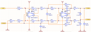

I'm using THS4561 in energy measurement application. I have quite high impedance resistor divided connected to mains (1.6M ohm and 6k) and then circuit as per attached picture.
I have 3 circuits like this and the problem is there is about 0.5% mismatch between them. I could see that in THS4561 datasheet resistors are relatively low value while these are quite high value. I wonder if such mismatch could be caused by using 178k resistors instead of, say, 10k?
