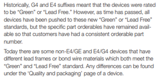

There is no difference; see [FAQ] Why does a logic device's part number have an E4/G4 suffix?

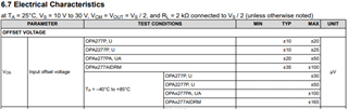

Hi Makoto-san,
As Clements pointed out, there are no differences these days among G4 and E4 suffix these days. As you may be aware, U is highest grade, and UA is the next grade, as prescribed in the datasheet.
If you have additional questions, please let us know.
