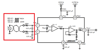

We have observed issue in lambda IC LM9044 (PN :LM9044VX) . Details are mentioned in table below .
Issue
At VIN+ open, Vout ~5V (instead of ~2V in OK IC sample)
For the case of an open connection at the non-inverting input, the device would Show 2V due to The internal non-inverting input bias current 380 nA flowing through the differential input resistance(1.2M) but the IC output showing 4.8V.
I don't know why it is behaving like that .
We have measured the voltage and current  between inverting and non-inverting terminal in open condition it is showing 1.16V ( calculated current is 1.16V/1.6M =725nA) which is more comparable to the normal Ic (0.45V) (380nA)..
Please support for above issue ...

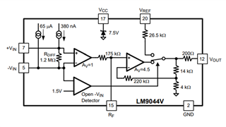

    LM9044's Vout  at ~2V is estimated based on a typical O2 sensor's input impedance of 1.2MΩ. If I am taking the variations of the non-inverting input bias current, say ±0.65uA and 1.6MΩ, this will result in differential input voltage of 1.04V. If the differential_input_voltage*Gain of 4.64V/V, Vout = 4.826V in cold sensor or open input fault condition.
    It is not conclusive to say that LM9044 IC is a failure case. Please provide us with the additional information.
    Raymond
  • During this high impedance condition the LM9044 will provide a default output voltage which 2V in cold sensor condition right ?
    Due to  internal non-inverting input bias current (380 nA typical) will flow through the differential input resistance (1.2 MΩ typical) and out the inverting input pin to ground. This will cause a voltage to be developed across the differential inputs:
    VIN(DIFF) = 380 nA x 1.2 MΩ VIN(DIFF) = 456 mV
    VOUT = VIN(DIFF) x 4.50
    VOUT = 456 mV x 4.50
    VOUT = 2.0V

  • Pls find above circuit which i am using....
  • hey Michael,
    Pls find schematic in below chat .
  • In normal operation device working good only in non inverting open condition it is showing 4.8v instead of 2v
    The 2V output voltage calculation is the typical output voltage based on the typical Ib and input impedance specifications. The typical spec is based on the standard deviation of the part distribution, therefore the vast majority of the devices will be within this typical spec, but not all. The maximum specification covers 6 standard deviations, and many devices will show performance somewhere between the typical and maximum specification. As Raymond pointed out, it is possible for a device to show 4.8V output based on values that are within these device specifications.
    How many devices are showing this behavior?
    Based on your measurements, it seems that the input impedance is slightly higher than the typical value but well within the max, and the IB is near the maximum specification. Although for a differential voltage of 1.16V, the output should be over 5V even with the minimum gain spec.
    Can you show the configuration that you used to measure the voltage and current between the input terminals? Because the non-inverting input is high impedance it is possible that connecting certain voltmeters to these nodes could add bias current or other errors that will reduce the measurement accuracy.
    one more addition point is that it is happening with only non inverting open condition not with inverting open condition .in inverting input open condition i am getting 2v which correct .
    The inverting open condition does not rely on the bias current or input impedance to provide a voltage output. Instead, an internal comparator switches the output to a resistive voltage divider that will produce an output of 2V when connected to a 5V reference voltage. Disconnecting both input pins should result in the output resistor divider. If you disconnect both input pins do you read ~2V at the output just like the inverting open condition?

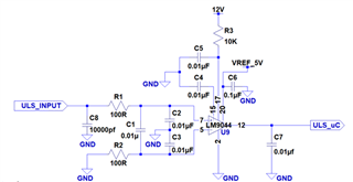

    Thanks for the information. Are you able to provide a layout of your board? Can you also provide a clear photo of your board showing the LM9044 and input connections?
    I believe the best way to move forward is to take a few more measurements under two operating conditions. See below.

    Can you provide the schematic showing the connections at the output of the device? What is connected at the ULS_uC pin?
    Can you test the input open condition with the ULS_uC node disconnected? What is the output voltage with only C7 connected to the output pin?
    Zach
  • hello Sir,
    1)What is connected at the ULS_uC pin-->>> We have Mounted above schematic on General Purpose board to analyze the input open Condition so  ULS_uC is not connected anywhere at this pin we were checking opamp output only..
    2)Can you test the input open condition with the ULS_uC node disconnected----> 4.8V output
    3)What is the output voltage with only C7 connected to the output pin --->4.8V output

    One more thing... Is the schematic you provided above the schematic for the general purpose board you are using?
    Can you provide a schematic of the board used in your application? I will need to see all the connections to the LM9044 as it operates in the field so that I can attempt to replicate the error. This includes the connections at the output of the device as it operates in the field. If you do not want to post the full schematic on this public forum, you may send it to me directly through a private message.
    Zach
  • Hello Sir ,
    Sry for late reply .....
    Whatever Info i had that i have shared with you ..
    In the schematic only we are providing input range from 0.1V--0.8 v and observing  output accordingly.
    It is not possible to share complete schematic hope you will understand ...

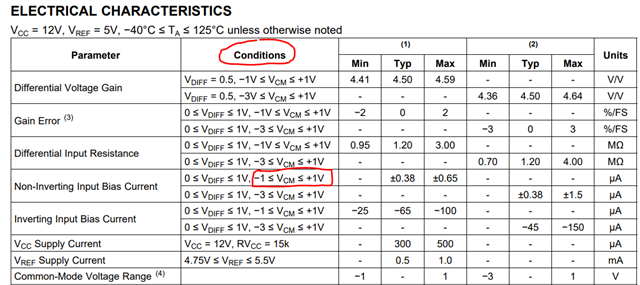

  • please find above attached screenshot of datasheet..
    As you said, the maximum specification covers 6 standard deviations, and many devices will show performance somewhere between the typical and maximum specification and it is possible for a device to show 4.8V output based on values that are within these device specifications.
    But according to the data sheet maximum open circuit output voltage is 0.423 x VREFF= 0.423 x 5 = 2.115V.
  • Hi Ajay,
    The max specifications for non-inverting input bias current and differential input impedance imply that an open circuit output voltage of 4.8V is possible based on the I*R.
    You are correct, that the open-circuit output voltage specification indicates a max of 0.423*5 = 2.115V but this is for a common-mode voltage ≤ 1V.
    If the floating inputs are somehow being pulled up to a common-mode voltage greater than 1V, this specification may not apply. I agree that under normal conditions, I would expect a maximum open-circuit output voltage of 2.115V.

  • Hi Zach,
    How could the common mode voltage possibly be greater than 1V?
    As, it is mentioned in datasheet that maximum value of VCM is 1V.
    please find below attached screenshot of datasheet.
    Ajay
  • Hi Ajay,
    The electrical characteristics datasheet contains the device specifications and the conditions under which these specifications are met. The min and max Vcm specification implies that this is the valid range in which the device is meant to operate. If the max Vcm specification is exceeded, the device may show performance outside of the specified range.
    Notice the "conditions" column for many of the LM9044 specifications require the Vcm to be less than 1V as part of the spec definition. The device specifications will only be met, if the required circuit conditions are also met.
    Notice there is also a condition of Vdiff <1V which according to your initial post, this condition is violated.
    It is possible that something is driving the input past the valid range, which results in performance outside of the defined device specifications. This is could also be excessive leakage current into the high-impedance non-inverting input node, due to residual solder flux or other contaminants on the board. Are you able to clean the PCB especially around the device inputs? Do you see the performance improved after thorough PCB cleaning?
