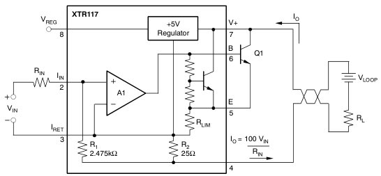

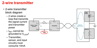

I have an adjustable output voltage on a circuit and our customer has requested implementing a 4-20mA transmission line with this.
Technically the adjustable voltage could create an adjustable current using a fixed load resistor, but thought it would need to be more sophisticated than this and a Current Transmitter would be need to measure the current on the line to provide a feedback loop.
Any advise would be greatly appreciated.
