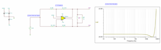

  • Hi JM,
    See TINA simulation below.
    THP210_CMRR.TSC
    Zach
  • Hi Zach,
    I currently don't have access to TINA on my work computer - looking to get that installed ASAP, though.
    Do you happen to have a higher resolution image of the simulation for now - it's very small on my screen.

  • Hi JM,
    If you drag your cursor over the image it should show a magnifying glass indicator. If you then select the image it should open up a larger, higher resolution version of the image. Let me know if this doesn't work for you.

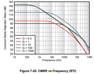

    I'm not sure I know  what you mean by "standard" instrumentation amplifier. Instrumentation amplifiers, just like normal op amps, come in both single-ended and fully-differential architectures. For example, the INA333 is a differential input to single-ended output instrumentation amplifier. Whereas the INA851 is a fully-differential instrumentation amplifier. Personally, I would consider the differential to single-ended INA to be the more "standard" architecture. If this is what you are referring to, you do not want to drive a differential ADC with a single-ended output as you lose half of your dynamic range and any common-mode errors are not rejected.
    Assuming you are referring to a fully-differential op amp such as THP210 vs a fully-differential INA such as INA851... The main benefit of the INA approach is that you have a very high-impedance input stage, 100GΩ for INA851. The input impedance of a typical FDA is determined by the input resistors chosen typically on the order of kΩ like the circuit shown in my last reply.
    Another benefit of the INA approach is that the CMRR is not dependent on external resistor matching. The CMRR is specified in the datasheet and is determined by precision matched resistor pairs that are integrated within the device. See figure 7-20 below from the INA851 datasheet.
    The FDA approach is typically chosen when the input to the FDA is low impedance, and therefore a high-impedance input stage is not required.

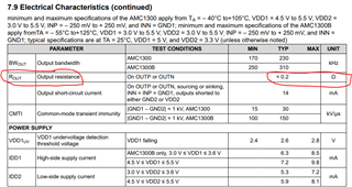

    I believe your original concern was that the output impedance of your isolation amplifier is too high and therefore will perform poorly. I used the TI cross reference tool (https://www.ti.com/cross-reference-search) to see if there is an alternative device with better performance. I was able to find the AMC1300 which has a very low output impedance of ~0.2Ω, see below. The 1ku pricing on ti.com looks quite good as well: https://www.ti.com/product/AMC1300.
    Zach
