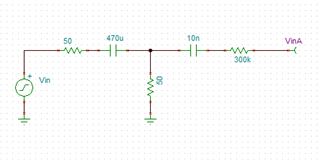

  • Hi Ashit,
    This is possible. The input resistance of the device is 300k-ohm.
    5*time constant (for a 1% settling) with 400-uF is 11 minutes.
    Why do you need such a high capacitor for your application?
    Can you not have a network like below? Then, the time constants will be less than 100ms.

  • Hi Karthik,
    Please find the response below:
    • We required high capacitors in our application to pass through very low frequency signals (~ 1 HZ).
    • In the network you had suggested, it looks like there is again a 10 nF capacitor in chain, won’t this increase the lower cut-off frequency to a very high frequency value?
    Nagaraju

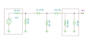

  • Hi Ashith,
    How about this network?
    R1 is source resistance which I have matched on the board with R4. If your source resistance is different, then change R4 accordingly.
    R3 and C3 are device's internal impedance.
    Frequency response from VG1 to VF1 is in the plot below. The gain is flat at 1Hz and -3dB bandwidth is 65.54mHz.
    To analyze the time constant for this network i) focus on the discharge of C1 which is in the red loop: 5 x 470uF x 10k-ohm = ~25ms, ii) focus on the discharge of C2 which is the blue loop: 5 x 10uF x 300k-ohm = ~15s. So, the dominant time constant between the two is from loop 2 which is about 15s which should be sufficient for your application.
