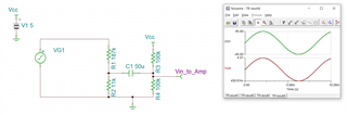

  • Hey Marvin,
    You can scale down the input, but doing an unscaled input of 250mV to 90V is not possible with general purpose amplifiers.
    The following circuit is assuming 90VAC is 90Vpp. If it's actually 180Vpp, you must scale down further.
    If you scale it down to 5V max, your new input range is 13.8mV to 5V, which you can do with a low voltage op amp.
    90V can be scaled down and placed at midsupply with the following configuration, then you can use a low voltage amplifier to buffer this to your ADC.
    This is if you need to keep your AC portion of your signal.
    If you just need the amplitude, you may use a peak detector as previously mentioned
