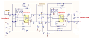

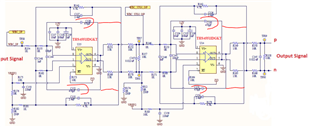

Hi
We are using THS4551IDGKT FDA and cascaded the FDA in 2 numbers . Please find the attached schematic . Is this cascading fine .
We connected the Differential P to second differential Op amp input Postive and differential n to second differential op amp Negative . Please check the connection is correct .
