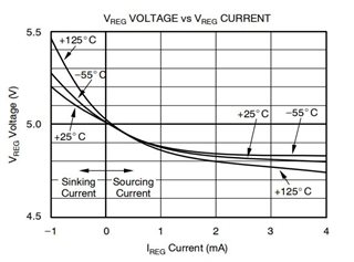

    From datasheet graph of XTR117 seems to supply 4mA of current.
    If we extend the graph, is the IC capable to drive 6mA typical & 10mA maximum current without falling below 4.5V?
    If not, can be bypass the Vreg pin without any circuit connection? or any circuit is needed for IC to work?
    There is reference circuit for bypassing Vref pin, do we have similar circuit for reference?
  • The loop current powers both the XTR117 and your circuit connected to VREG. The XTR117 takes at most 250 µA, so if you want to be able to output 4 mA, your circuit must not take more than 3.75 mA.
    If your circuit is powered by another supply, then leave VREG open.
    When there is no input signal, Iout has to be less than 3.75mA in the system --> this is the requirements, otherwise, you will not have 4mA-20mA output as a function of the input.
