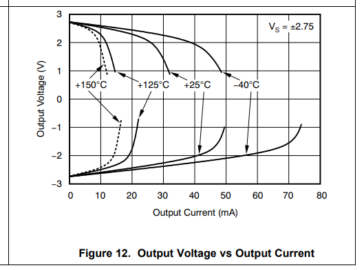

Hi Folks,
Do we have an idea on what the minimum short circuit output current would be?
  • Hi Chris,
    The datasheet implies that Isc is capable to source 30mA and sink up to -50mA at the test conditions at 25C. This is a low voltage op amp part up to 5.5Vdc for single supply rail or ±2.75Vdc in dual supply rails.
    If you have other questions, please let us know.
    Raymond
  • The OPA2376 short-circuit current, Isc, is a strong function of supply voltage and temperature,  At 125C on +/-2.75V (or +5.5V single supply), Isc may be +10mA/-20mA (see below) while on lower supply Isc will be even lower.
