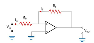

The virtual short concept is only applied to op-amps in negative feedback configuration, and not in case of positive feedback.
Is there any plausible reason for this?
My expectation is that mathematical proof which explains why it is applicable to negative feedback and not applicable to positive feedback

    Please see the positive feedback circuit below.

  • Hari,
    Thought experiment first for top schematic. Let's assume that VIN, IIN, VOUT, and IF are all zero at time zero. This is a potential balanced point with a potential virtual short. Now VIN rises which will apply positive voltage on IN+ because VOUT can not change instantly. Input voltage difference is positive. Op amp gain is positive. So output will start to go positive; RF will increase positive voltage on IN+ further. Eventually VOUT reaches maximum voltage VOH (after slew rate time). Both VIN and VOUT are positive so IN+ is not zero.
    Research hysteresis comparator; that is the top schematic.

    I know this is a comparator and it's in positive feedback.
    The inverting input is grounded and I am not able to explain a third person why non inverting input is not 0V.

  • Math and image taken from sloa011b, good to read all of it
    What happens when op amp gain '-a' becomes a big negative number. circuit gain 'A' becomes a very big negative number that is not set by the application two resistors. In summary you can't just swap the inputs and expect a similar results in a close loops system.
