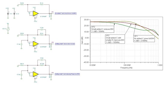

  • Bob,
    The problem may be parasitic capacitance in conjunction with resistors slowing down the circuit.
    The RC time constant in the signal chain and feedback loop effects the BW.
    I insert diagrams below of 3 OPA847 op amp circuits all in non-inverting gain = +20 V/V.
    Top circuit has resistor values you show with no added capacitance and give full expected BW f-3dB = 210MHz
    Middle circuit has resistor values you show with 2pF added capacitance at inverting input and across feedback R. The result is BW is reduced to f-3dB = 50MHz, same as you mention.
    Bottom circuit has resistor values change to 5x lower and with 2pF added capacitance at inverting input and across feedback R. The result is BW is improved to f-3dB = 160MHz.
    For best BW performance, RC time constants need to be minimized.
    To minimize C: remove ground and power planes from under the inverting input node, output node and feedback resistor, and traces should be as short as possible.
    To minimize R: the gain setting resistors should be kept as low as possible.
    The OPA847 data sheet shows BW over 200MHz should be achievable in gain of +20V/V with RF=750 ohm and RG=39.2 ohm.
     I also attach Tina file you can simulate.
    7571.opa847_G=20 + Cparasitic.TSC

    2.  As shown in your attached file, when the resistor values change to 5x lower, the BW can be improved to f-3dB = 160MHz. In my real circuit, I can also use such values of resistors (Rf=200, Rl=10), as shown in the figure below.
    But are there some problems with such low-value resisters?  For example, the impedance matching, etc.
     Again, thanks a lot for your help!
  • Bob,
    #1. I think answer to G= 10V/V is in post at  http://e2e.ti.com/support/amplifiers/high_speed_amplifiers/f/10/t/74579.aspx
    Easiest solution is to use OPA846 for G= 10V/V.
    #2.  No problems for the impedance matching. The main problem is distortion worse because feedback path loads the amplifier; see data sheet plots of "HARMONIC DISTORTION vs LOAD RESISTANCE" at top of page 5. The 200/10 resistors will move the device from far right side of plots to around 200 ohms. If this performance is not enough, you may have to spin the board to remove GND/Power planes and reduce parasitic capacitance.
