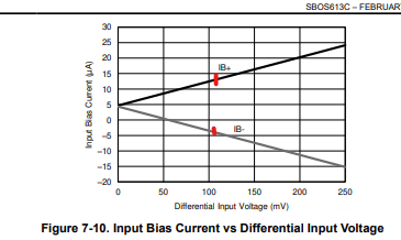

    The input filter will improve noise immunity. Please take note of the expected input bias current at the shutoff differential voltage of ~107mV.
    Currently, we have reserved a 0 ohm resistor in IN+ and IN-.  And we will pay attention to the impact of input bias current if we need to adjust this resistor in the future.
