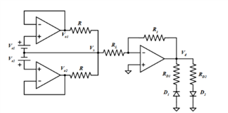

I dont quite understand how this circuit works. Can anyone help me analyze this circuit?
I only understand the second stage (the inverting output) but i have no clue about the left part.

It looks like a inverting summer circuit but instead of sources, they are produced by buffers:

The math for Vx is RL/R * (Va1 + Va2). When RL terminates to ground. A virtual ground in this case.
The left side is a self referencing summer that adds currents to Vx node, so Vx would go infinite gain without a load RL. I can't think of a practical purpose for this circuit.

Could you tell us more of what the application is?
We would like provide a purposeful circuit with a more modern device, if possible.
