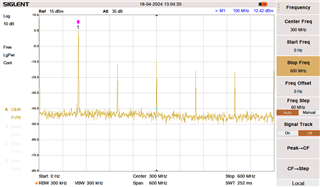

The problem is, I am seeing is distortion (compression?) when trying to get 13dBm out of the device at higher frequencies. The part performs well up to around 100MHz. With increasing drive, the harmonics start to rise and eventually goes unstable and shows huge distortion with harmonics and sidebands.
Two plots show an input signal level of -4.0dBm and -2.0dBm.
The requirement is to output 13 spot frequencies between 1 and 250MHz at an output power of approximately 13dBm (2.8V p-p) into 50R.

    The 13dBm spectrum on the right it looks like the device is clipping to me. Have you confirmed with an oscilloscope what the output looks like in that state and if it is clipping? From the left to right plot you increased the input power 2dB, but the output changed from 12.42dBm to 13dBm which isn't a 2dB increase, further telling me that it is clipping. Does the measured 13dBm look better at lower frequencies?
    With the 50ohm R34 and what I assume is a 50ohm spectrum analyzer, the measured 12.42dBm on the left would really be 18.42dBm on the output pin of the device or about 5.27Vpp. This would also mean that the gain isn't 20dB but more like 22dB, have you confirmed the gain? If you changed the gain on the EVM to 10V/V did you change the Rf resistor?

    Yes I think it is clipping. Scope shows the onset of distortion. I can get a little more power if I up the rails to +/- 6V but device performs well at lower frequencies providing over 13dBm with +/-5V rails.

    Curious observation. I been driving this from a DDS  AD9910 eval board sweeping up and down from 1MHz to 250MHz. On the up sweep, the harmonics could be seen rising at higher frequencies (as per my 1st plot) but only on the down sweep could I make it go completely unstable (as per my 2nd plot). I reproduced this using a bench RF signal generator. I have not been able to explain this.

    I think I was able to replicate this behavior on the bench. With an Rf=140 and the G=5V/V, 13dBm on the spectrum analyzer was seeing those spurs from about 110MHz on my setup up to about 200MHz, sweeping both directions. Increasing the supplies to +/-6V made it go away. Looking at the waveform with an oscilloscope it did look like a distorted sinewave not a clipped output limitation. The gain of the part also varies a bit over frequency by 1-2dB so the amplitude isn't totally flat, but that doesn't make it output limited.
    I increased the Rf of the OPS from 140ohms to 200ohms, keeping the gain at 5V/V, and that improved the distortion. Instead of the 110-200 MHz range it shrunk to 140-160MHz, and 200-210MHz. Increasing the Rf further to 300ohms eliminated the problem.
    I think there might be some stability problems with the output amplifier in this specific configuration and in these specific frequencies. Increasing the Rf of the OPS will help with stability since it is a current-feedback amplifier. This will limit the bandwidth a bit so there are tradeoffs to that. Other things that might help with stability would be better decoupling.
