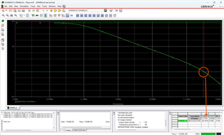

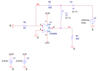

Hi Team,
1.The customer use pspice to simulate the open loop gain of OPA858, but it doesn't meet the data in the datasheet, only3.2G.
Here attached is the simulation files and snippet.
opa858_ac_sweep.zip
Test condition mentioned in the datasheet: VS+ = 2.5 V, VS– = –2.5 V, VIN+ = 0 V, RF = 453 Ω, Gain = 7 V/V, RL = 200 Ω, output load referenced to midsupply, and TA = 25°C (unless otherwise noted)

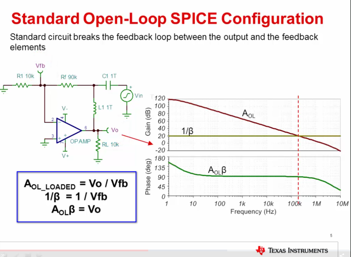

Test method as below:
Stability-->Spice simulation @ 3:04
https://www.ti.com/video/series/precision-labs/ti-precision-labs-op-amps.html
2.Why Aol_loaded=Vo/Vfb and 1/beta=1/Vfb?
For opAMP, (Vin+-Vin-)*Aol=Vo, Vin+=0V,Vin-=Vfb, so Aol=- Vo/Vfb.
And Beta=Vfb/Vo, so 1/beta=Vo/Vfb,
Please help to explain how do you get the equation in the training video.

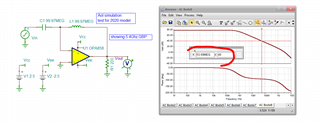

  • you might be confusing Aol = 0dB with GBP, normally you would project the Aol gain at 40dB to GBP multiplying that frequency by 100X, 5.4GHz here looks correct
    These issues are described in this article,
    https://www.planetanalog.com/why-is-amplifier-gbp-so-confusing-insight-12/
  • Hi Michael,
    Thanks for the feedback. I've read the article, but still a little bit confused.
    Which one is the actual GB shall we use, @0dB or @40dB*100?
    Do you mean we can trust the simulation result at 0db, the real GB is 3.2G, the reason why the datasheet shows is 5.4G is due to they use 40 dB to estimate?
    Or you mean the simulation model has defect, we can trust the data @40dB*100, It is 5.4G.

  • Hi Ba,
    GBW product is defined only when Aol is rolling off at a rate of -20dB/decade. When a devices' Aol starts rolling off at a faster rate (due to additional higher order poles), we cannot use the GBW calculation and any result from that calculation is not valid. This is why Michael used a data point at 40dB, as this will ensure he is in the Aol region where it is rolling off at -20dB/decade. For most higher speed devices, higher order poles will influence the Aol by the time it is around 0dB, therefore we don't take the frequency at 0dB to calculate GBW and instead take the approach Michael took to get GBW for our devices.

  • Hi Ignaccio,
    Thanks for the feedback, this makes sense. Could you please help answer my second question?

  • Hi Ba,
    Since the circuit is setup to measure Aol, Beta, and loop gain by opening up the feedback loop. The small AC signal source is injected into the feedback network through the C1 capacitor, Beta will not include Vo as it is now open. Instead it will be R1/(R1+RF) like mentioned in the second image. This is also equal to Vfb. Vo = Vfb*Aol, as Vfb is the direct voltage value at the input, which is what is gained up by Aol.

  • Hi Ignaccio,
    Thanks for the feedback. I understand that Beta will not include Vo as it is now open. But Vfb= the injected Vin*R1/(R1+RF), if Beta= R1/(R1+RF), Vfb= Vin*Beta.
    Vfb=Beta only if  Vin=1? Why we consider Vin=1? Please fell free to correct me.
    Eric Ba

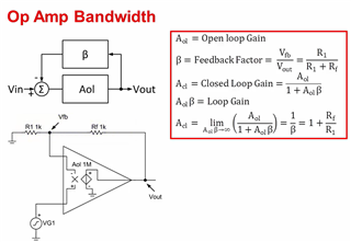

  • Hi Eric,
    The beta term is a unitless factor, which would be Beta = Vfb/Vin = R1/(R1+Rf), which happens to be at the node we label Vfb.
    Ignacio
  • Hi Ignacio,

  • Hi Eric,
    Th ac simulation takes the transfer function with respect to where you are probing relative to the input signal. So, by probing at Vfb the simulation is actually giving you Vfb/Vin which is also the beta term we are calculating. I am not sure if that is the point where it is not clear. The Vfb node can be labeled anything but at that node the simulation is capturing the beta factor we are looking for.

  • Hi Ignacio,
    It is still not clear for me. Let's go back to the equation.
    Beta = Vfb/Vin = R1/(R1+Rf), I have no question about this.
    But why the we say Beta = Vfb, In the simulation, we can get both Vin and Beta.
    Please look into the video below. In the simulation, If it use1/Beta=(R1+Rf)/R1, I can understand. But it use 1/Beta=1/Vfb, I don't understand, I think it shall be 1/Beta=Vin/Vfb. Why Beta=Vfb?

  • Hi Eric,
    I see where the confusion is coming from. So, keep in mind when we probe any node in the circuit and do an AC simulation, it is capturing the gain with respect to the input signal, and it will give you a transfer function for that node. Therefore, probing at the inverting node, we will get the gain at that node (Vfb) relative to Vin, which will be Vfb/Vin in the ac simulation. At that node, it also happens to equate to beta. When running the simulation, and adding the 1/beta formula, you are actually setting 1/beta = 1/(Vfb) = 1/(Vfb/Vin).
    Ignacio
  • Thanks for this strong support. That makes sense.
