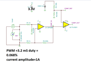

my customer is interested in simulatie the High speed over current detection concept based on the application note
https://www.ti.com/lit/an/snoa987a/snoa987a.pdf
They have a very short 1µs pulse signal and are not able to get reasonable simulation results.
I tried to simulate this concept, but it is not working for the PWM 304Hz and shortest PWM=1uS
I am getting negative voltage output
