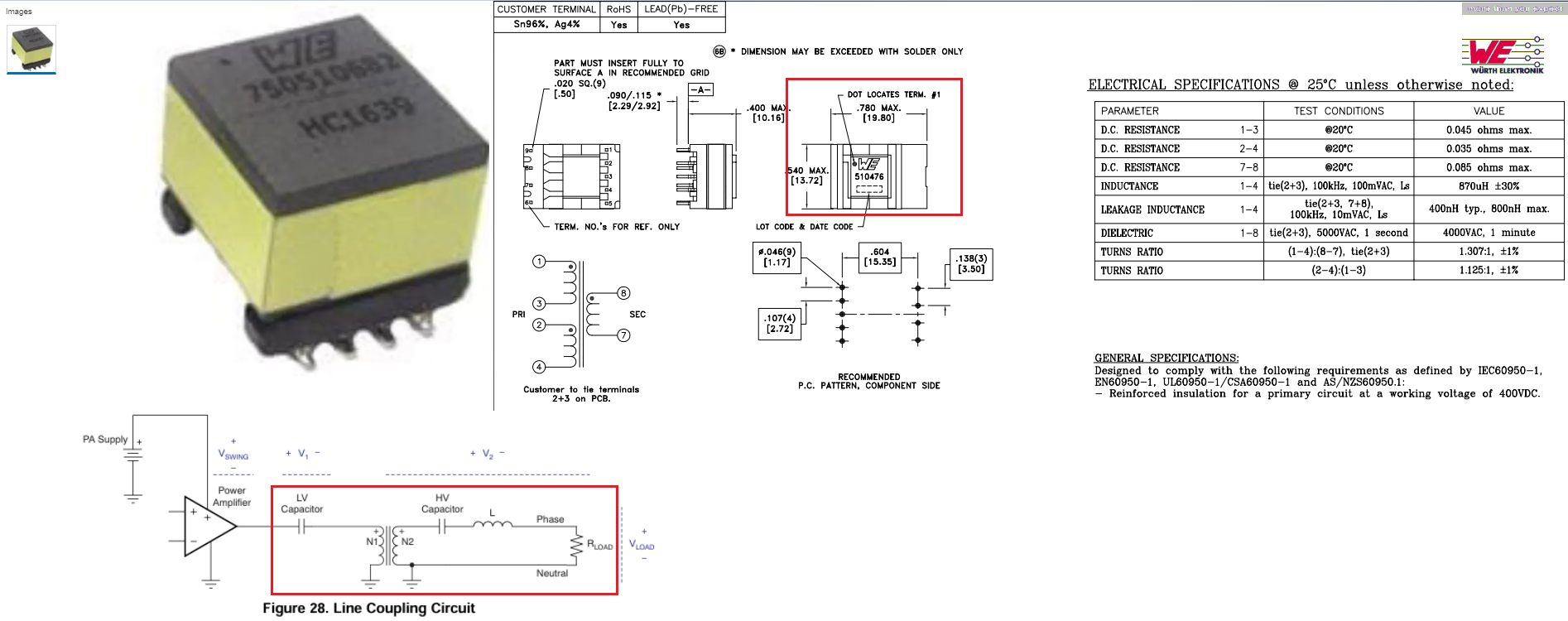

1) Does it required to have have line coupling circuitry while being used in 220V/230V, 50Hz.
The AFE031EVM is the basic PLC communication PCB, the coupling circuitry that is coupled to the AC powerline is not included. The AFE031 may be coupled to DC or AC powerline, and difference powerline interface require different coupling circuitry.
The image above is the AC powerline coupling method, and link below is the transformer that is recommended for the coupling interface.
https://www.mouser.com/ProductDetail/Wurth-Elektronik/750510476?qs=k8ubvZJoN9A8PH7BTOuOqw%3D%3D
https://www.we-online.com/components/products/datasheet/750510476.pdf

Thank you for your reply with the circuit diagram.
My company and I are planning to develop a "Proof of Concept" on PLC technology. Could you please provide a real-life picture of the AC line coupling with AFE031? Having a real-life picture will greatly assist us in building a more solid belief in the product, as visualizing the practical application enhances our understanding and confidence in its capabilities.

Hi Sumit,
The size of the AC transformer is 20mm x 15mm, plus the other components. HV capacitors may have larger size than the transformer. The actual dimensions depend on the actual application and protection circuitry between output and AFE031's controller side.
This is power system interface, and it will not be very compact. But you should be able to design AFE031/Transformer interfaces about the size of iphone in area. The height will determine the size of enclosure.
