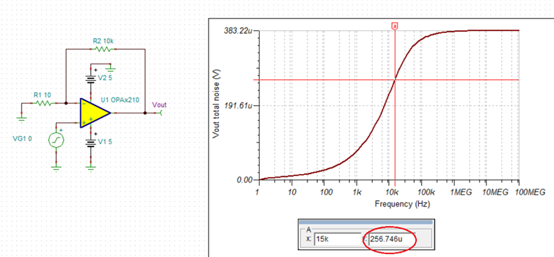

    3. In the G=1,000, the output noise is 256uV (see below) - this means that the input refer noise would be 256nV.  Thus, the minimum input signal would need to be above 1uV to get decent signal-to-noise ratio.

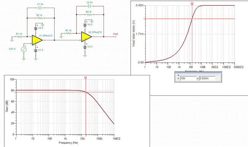

    Using two cascaded op amps in gain of 100 each, will result in the overall gain of 10,000 and bandwidth of 31.8kHz (fc=1/(2*Pi*RF*CF) - see below.  This results in the total output noise of 2.6mV that translates to 260nV input refer noise.

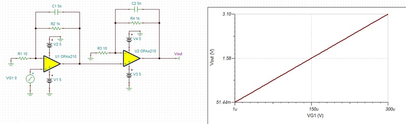

    The circuit would allow you to amplify 1uV to 300uV input signal as shown below.  Please make a note that the OPA2210 output linear range is 200mV above negative rail so if you plane to use a single supply this will further limit the minimum input voltage as you must also account for the max offset of +/-35uV.

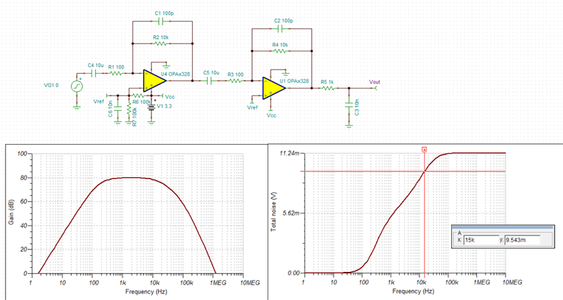

  • Hello Marek,
    Thank you very much for your inputs, my requirement is that minimum signal that needs to be amplified is 100nV, please suggest me alternate part that would be more suitable for this application. My power supply constraints are 3.3V and I don't have a negative supply.

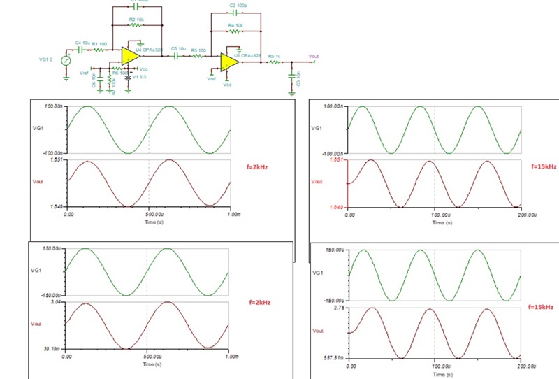

  • In order to work down to 3.3V single supply, you could use OPA2328 with output referenced at mid-supply (Vref=1.65V).  However, considering the total input referred noise is about 1uVrms (see below, Vin_noise=Vout_noise_total/Gain =~9.5mVrms/10,000 =~950nVrms), applying 100nv input signal will be swamped by the noise and there is not much you may do to fix this including using a different op amp - the input signal is just too low.
    AC coupling the signal as shown below results in following output waveforms for 2kHz and 15kHz sine input with 100nV and 150uV input signals.
    This could be further optimized BUT detecting 100nV signal will be very difficult to obtain in roughly 10x higher noise floor environment.

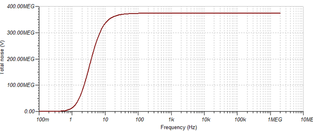

    If I use OPA892, would I be able to get some hundreds of nanovolts amplified, I intend to use it in two stages, first one with gain of 1000 and cascade stage with gain of 100. Could you please let me know, if possible, a simulation file would be very helpful. My application requires very faint piezo signal to be amplified.
  • Sumeet,

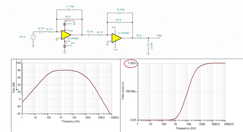

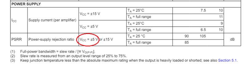

    Assuming a bandpass filtering shown below, using OPA892 with its broadband noise below 1nV/rt-Hz would result is the input referred noise of around 152nVrms (1.52mV/10,000) and thus could be able to measure a piezo signal in hundreds of nV - see below.  BTW, as I mentioned before, a gain of 100,000 could NOT be used for upper range of the input signal in hundred of uV because it would require the output signal in tens of volts, which is not possible on 3.3V supply.
    However, OPA892 minimum supply voltage is specified as 10V (or +/-5V) and thus it would NOT work on 3.3V single supply - see below.
    Below I have attached OPA892 schematic for your customer's convenience.  Since OPA892 belongs to HSAMPS product line, please contact them for further assistance.

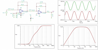

    If you changed the op amp from OPA2328 to OPA2992, here is the simulation, see the attached file.

  • Hi Sumeet,
    I was able to look at the circuit you shared, and I am not sure how you are implementing the first stage. One concern as well is the very high Rf resistance. Due to bias currents, having such a high feedback resistance will cause an offset and will result in a saturated device. I would suggest starting out with the first stage as the addition of the remaining stages adds a higher level of complexity. I attached a reference for a charge amplifier circuit that shows how to design this type of circuit. The circuit highlighted will be a good starting point for your design.

  • Hi Sumeet,
    I was wondering if you could send the signal you are seeing at the output of the first stage? The device is not biased correctly as is resulting in erroneous results. On top of that, the minimum supplies required for this device is 9V, which will affect the devices performance.
    Ignacio
