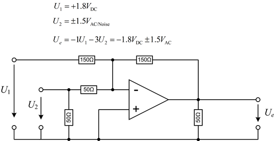

I would like to design an additive op-amp circuit with two voltages, one gained by 1 and the other gained by 3. The supply voltages dont matter, I have anything.
The input voltages are AC 1Vpp that should be AC 3Vpp at the output (gain 3) and an additiv bias that should be gained with unity gain to -1.8V.
The frequency behaviour should be quite linear up to some MHz. The cutoff frequency can be around 10 KHz, or much higher, this doesnt matter.

    Perhaps you could provide some more detail so that we can offer some advice:
    What do you mean by "some MHz?"  Can you provide a number?
    You apparently have a circuit topology in mind. Could you please provide a schematic? This would help us to understand your description of the desired circuit function.
    The second signal at unity gain... is it DC or AC?  If you could provide drawings of the desired waveforms it would help.

    This is my circuit scheme:
    The U2 Signal is kind of noise-signal (Arbitrary Waveform) and has a in the spectrum a 3dB cut off frequency around 5kHz. Therefore, it is sufficient if the OP-Amp can drive frequencies within the Signal up so some Mhz. Lets say 10 MHz cuf off of the OP-amp is sufficient.
    The second signal at unity gain is DC, yes.

    With your noise source rolling off at such a low frequency (5kHz), there seems to be no reason why the resistors are so low. I'd scale the resistors up by a factor of 100, use an OPA350 operated on +/-2.5V.
    Unless there is some need for impedance matching to an external signal generator, rempve the 50 ohm resistor from the op amp output to ground and from the U2 input to ground. This will not affect the signal gain, only the severe loading caused by the low resistance. If the frequencies were well into the MHz region there would be good reason to keep impedances low but that is not the case here.

    Further: Im connecting U2 with SMA-Cables, these need to be terminated with 50Ohm, so I would then still need these for impedance matching to an external signal generator. So the two 50Ohm impedances to ground are then still right, isnt it?

    At the low frequencies that you are using,, impedance matching coax cables by terminating them in their characteristic impedance is completely necessary.
