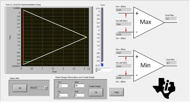

Below is the image from TI calculator.
I choose the common mode voltage as 0.3V using the slider
From the above image what I understood is I need to provide a minimum gain of 40 because my maximum signal is 10mV.Please correct me if I am wrong
May I know how to accommodate the offset of -.3V

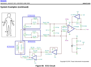

  • Hi Hari,
    Could you share your ECG/EKG schematic or simulation with me? Below is an example from INA826's datasheet. Certainly, you can use INA333 to perform the similar design.
    Here is INA333's ECG example.

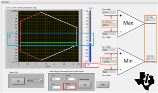

    If you are using INA333 with 3.3V single supply rail, you would need configure the Vcm in the middle of the unsymmetrical hexogen diagram, where ECG input can swing positive and negative below ground (up to 10mV). The marked orange boxes are the designed differential min and max input range, and INA333's min and max output range is shown on the right of the orange box. I selected Vref = 1.25Vdc for the configuration.
    You may compensate the Vos via Vref signal (Vref = 1.25 +0.3V) or calibrate it out in your ECG/EKG system.
    Anyway, we can simulate the design requirements once you finalize the basic parameters. Please let me know if you have other questions.
