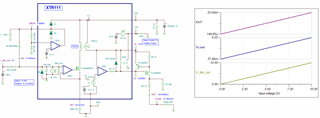

    This is 150 µA - 25 mA current loop transmitter for XTR111.
    XTR111_0-10V_to_0.15-25mA 06042024.TSC

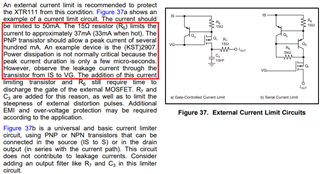

    The selection of PNP in Figure 37a has the current limit at approx. 37mA. 15Ω*37mA = 0.56V will forward biasing the emitter and base and turned on Q1 and pull the Q1's gate high to protect Q1 NMOS. You should select PNP that is capable to dissipate the power when Q1 is turned on. Or use 2N2907 BJT.

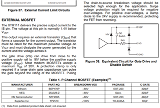

    Please see the paragraph above, and the guidelines how to pick the external mosfet.

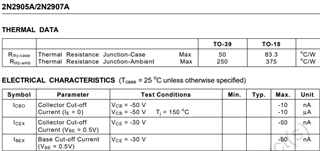

    The XTR111's datasheet is specified that the leakage current is < 1uA. For your current loop range from 150uA to 25mA, the error is approx. < 0.67% at the low end.
    I think that the the datasheet refers to Iceo (~10nA) and Icex (~50nA), where 2N2907 has low leakage current < 100nA between emitter and collector. Some of power PNPs, the leakage current figures are in the sub of mA, which is not suitable for the application (high precision current loop transmitter). It also goes up as a function of temperature.

  • Hi Raymond, thank you, exactly, it seems to me that collector cut-off current (ICEX) @ VBE=0.5V and its thermal stability is the parameter I need to pay particular attention to. Most transistor specs do not provide this value but at least DigiKey allow search by collector cut-off (Mouser does not). This thread mentions MMBT2907A as a good alternative with ICB0=10nA which allows to hope for a low ICEX - it is 50nA in case of Diodes Inc product, they specify it while NXP does not.

    Figure 37b and two pnp transistor limiter is much different story - a second choice since my preferences are simplicity and small PCB area.
