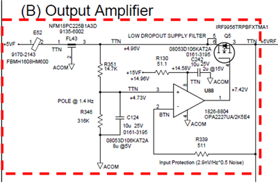

Block Diagram

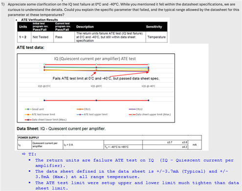

Defect part was sent to FA, and TI conclude TNI (Trouble Not Identified). They confirm these return units are within the data sheet specification for IQ parameters, but for applications which is failure abnormal signals require application review.

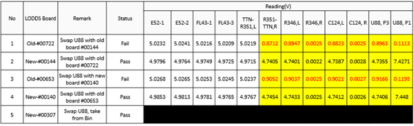

  • Hi Alex,
    This is the only pictures we have since the part already sent to TI's FA.
    1) Chamber reading for 25 Degree Celsius
    2) Chamber reading for cold temperature 0 Degree Celsius
    3) Voltage measurement on Good and Bad part, referring to block diagram above
    **Remark: U88 IC is the OPA2227. The failure can be duplicate when install the defect component on another good LODDS board. When take the other OPA2227 component from another good LODDS board and from bin stock, both are pass. Means the component from good LODDS board is good, with same setting input etc.
    I will feedback to production team on the input signal of 8MHz. Do you have any other thoughts or concerns you'd like to share?
    Amira
  • Hi Amira,
    Thanks for your patience.
    • Can you verify the node TTN (+5VRF) is at 0V when the problem occurs?
    • Can you check pin 2 of the opamp while the problem occurs and verify that when pin 2 < pin 3, the output hits the negative rail?
    • If you can verify that the inverting terminal is sitting at a lower voltage than the noninverting terminal and the output is still at the negative rail, then there may be a problem with this amplifier.
    • Additionally, can you verify that the amplifier operates as expected at 25C?
    • Can you provide information on the FA report so I can locate it on my end?
