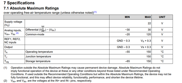

I am using INA296A3IDDFR for current measurement in my BMS application.
Circuit is designed as per attached image. I have provided 1.25 reference voltage as I am doing current measurement for bidirectional application.
1. When current is '0' - voltage at output pin (pin no. 5 0) ~1.25
2. During discharging, negative current, voltage at output pin starts decreasing upto 0 (pin no. 5 0) <1.25 - ) ,during short circuit 0V
3. During charging, positive current, voltage at output pin starts increasing upto 3.3 (pin no. 5 0) >1.25  )
IC is functioning as expected, but for 2/ 3 times during running condition, output of the pin became 0 to 0.1V permanently even when current is '0'.
I am not able to find the reason what could have damaged the IC.
Request your support.
We have performed multiple short circuit tests. During short circuit, it outputs 0V, as soon as BMS turns off MOSFET, current becomes 0 and IC resumes to 1.25V without getting damaged.

    Is there any way that during a transient you have the VCM go below -20V?  During transient?  Is the power  3.3V and reference 1.25V independent of the BMS being off?  This part is robust and I have not seen issues while the inputs are in the acceptable range.  So I would not expect damage if within Absolute Max Conditions.

    4. As I am using for low side sending, I don't expect input voltage greater than 110V which is maximum limit of Device in case it is causing damage due to transient. I haven't observed any negative transient on scope. I need to check. Shall I try TVS diode for negative transient?

    I believe the issue could be the negative transient.  I would confirm the input does not go below the -20V.  I would try a TVS diode for the negative transients and see if this will work with the filter resistance much lower.  Transients creating a delta V between N_GND and BAT.
    5. Is there any other option?
    Looking at the pins during power-up would be helpful in determining the root cause of the issue.  By just increasing the Resistance of the input filter would lean toward a voltage transient.  Can you maybe describe the pin conditions during power up or get a scope shot?  I think the biggest pins to be concerned with is Inputs, Vref and Supply.
