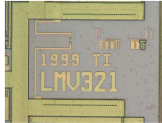

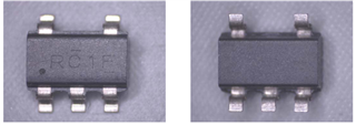

Hi
We found two kinds of internal wafer marking for this product. Could you please help confirm the reason
thank you
Hello Li,
LMV321 had a PCN (product change notice) that added a new fab process and design.
Partial PCN below. The left die is this new fab process and design.
Let me know if you have any electrical issue with left die. I expect you do, why else would you look at the die?
