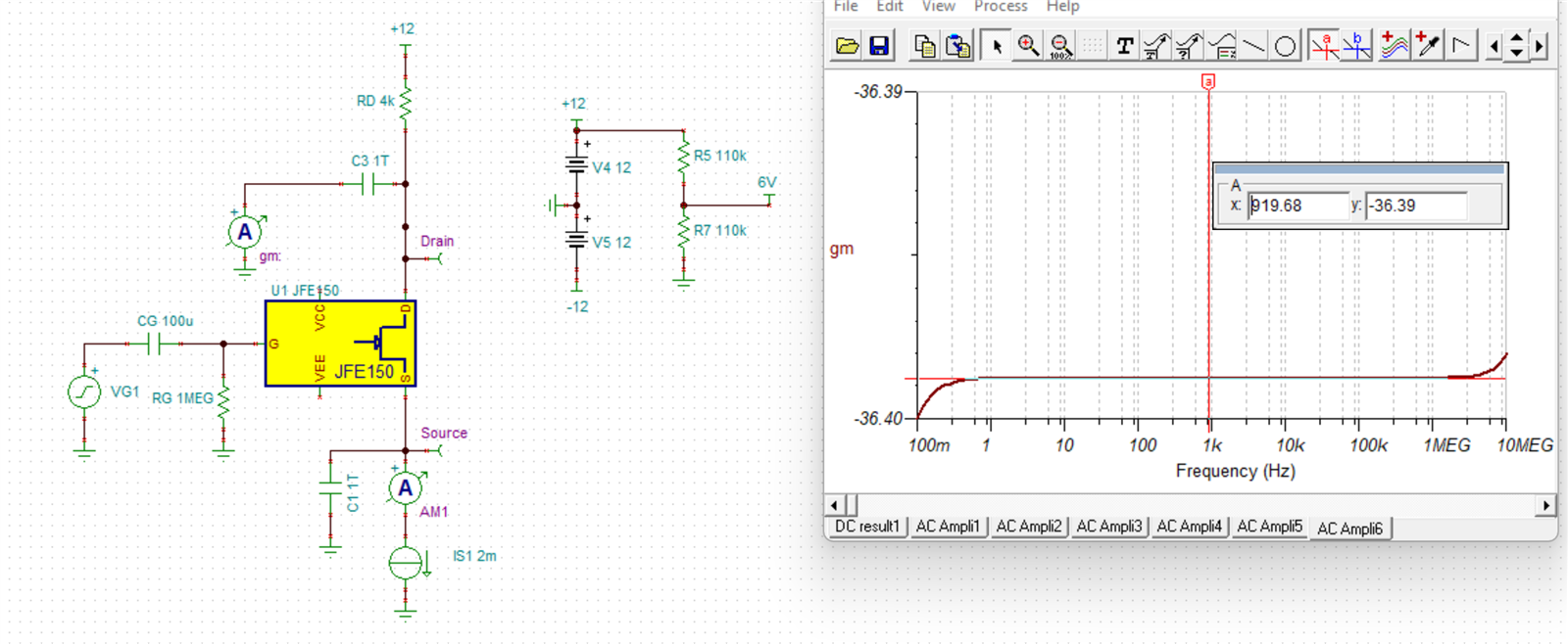

    The circuit for simulating gm is shown below. A constant current source is used to force a desired Ids current. A 1TF capacitor is connected to the source of the JFET such that at frequency the source is ground. This ensures modulation of Vgs. Given that the current source has an ideal infinite resistance we want to make sure we bypass that resistance at frequency in order to keep the source at AC ground. Otherwise the circuit acts as a source follower. A 1TF capacitor is added at the drain such that at frequency all the AC drain current flows through C3. A current meter is added in order to measure gm. The 2mA DC current flows through RD = 4k. RD ensures a desired VDS voltage is achieved. The DC parameters can adjusted as desired to determine different values of gm.
    The JFET gain parameter gm is shown above vs frequency. Converting the decibel result to the linear scale we get a gm = 15.7mS.
    Here is the Tina file to simulate gm. I also elaborate a little further on using gm in the calculation for my JFE2140 application note.
    https://www.ti.com/lit/an/sboa563/sboa563.pdf?ts=1720802668546&ref_url=https%253A%252F%252Fwww.ti.com%252Fproduct%252FJFE2140%253Futm_source%253Dgoogle%2526utm_medium%253Dcpc%2526utm_campaign%253Dasc-null-null-GPN_EN-cpc-pf-google-wwe%2526utm_content%253DJFE2140%2526ds_k%253DJFE2140%2526DCM%253Dyes%2526gad_source%253D1%2526gclid%253DEAIaIQobChMIvLCRuPmhhwMViQ6tBh1AgwRvEAAYASAAEgKnIfD_BwE%2526gclsrc%253Daw.ds
    gm Tina sim:
    JFE150 gm (1).TSC
