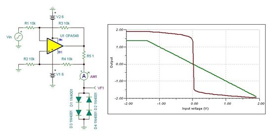

    Here is a modified Howland voltage controlled current source using the OPA548 power op amp. The output current is -Vin/R5. I've shown diodes as a load to demonstrate that the output current is accurately proportional to input voltage regardless of the obviously nonlinear load voltage.
    The OPA548 is a bit marginal on positive output voltage swing on +/-6V supplies. You can see this as the output limits at about +1.9V and 1.4A. This is close to the max condition of your AC waveform at a 2 ohm load and this simulation is with a nominal device, not the worst case. If you could get an additional volt on the power supplies, you'd be in good shape. Alternatively, you could gain some margin by making R5 a smaller value. If you make it too small, input offset voltage may create an unacceptable output current offset.

    I will try the OPA548 circuit and see how it performs.

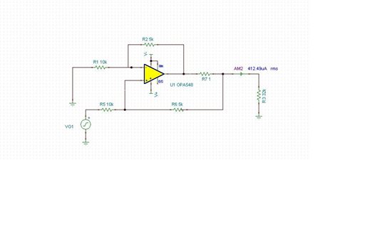

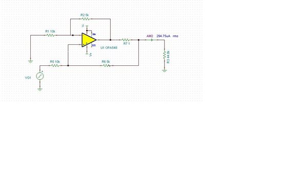

    Yes I understand what you are saying is true. But apart from that, resistive load regulation is not good as well. Can you look at the attached two pictures. The difference in current would be amplified on the secondary side :)
    Is there a better way to regulate with such high impedances ?? Or am I missing something here ?

    If you change R2 to 5001 ohms I think you will see better performance. You have R7 set to such a low value that a tiny voltage must be developed on this resistor to create the small output currents you are simulating. This makes resistor ratios extremely critical in order to achieve high output impedance. If you are using the OPA548 to create amps of output current, perhaps the change of a hundred microamps is not critical. I'm not sure of your actual needs. If you need very small currents, I suggest making R7a much higher value. R2 should be made equal to R6+R7.
    You may want to read this Bob Pease application note on the Howland current source. It provides an intuitive look at the issues of the Howland (improved Howland, in your case). It will help you optimize for your application. If you have further questions, it would be wise to start a new thread with more background information on your requirements.

    I actually did create a new thread in 'Audio Amplifier's' section but did not get any replies. Changing R2 to a better value did help a bit. Later on, by reading Bob's paper, I think improved Howland pump would not give me 100% accuracy at all load levels. I would try to see if their other topologies, which I can use to realize the design. Thanks for the help again :)
