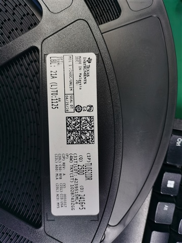

This is the sales for SCHNEIDER China, and my customer has received two batches of TL052IDR, which are from Mexico and Malaysia Assembly location.
The problem is they test their board and found the power consumption of 16*TL052IDR is 250mA which are from Mexico Assembly location, but the total power consumption of  16*TL052IDR is 187mA which are from Malaysia Assembly location.
So they wanna know whether are there some different impact between Mexico and Malaysia assembly location. The attachment is the label.
