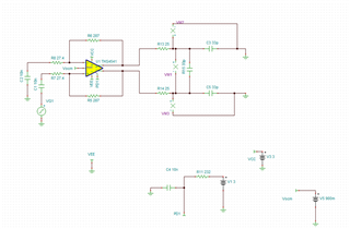

First off, I wanted to provide you with a description of what changes were made to the evaluation board. Below is the schematic in the simulation tool TINA. The schematic I altered is the one found in the THS4541 EVM User’s guide. In short, the transformer after the amplifier was taken out and the resistor values were adjusted, so the gain would be like what is seen in Seeker X which is about a gain of 10. The parts that were changed are: R26 and R27 were taken out, R7 and R8 were changed to 27.4 ohms, R5 and R6 became 287 ohms, R13 and R14 are now 25 ohms and lastly R15 is now a 33-pF capacitor followed by R20 and R21 being the same value capacitor.

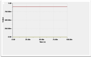

Above is the TINA simulation when the input signal is removed. I’m wondering if you can give me an explanation as to why there is a discrepancy between the simulation and what I see in lab with the circuit at DC conditions. In addition, do you have any ideas for schematic changes or maybe different part that could be used in substitute of this amplifier to get a desired output?
  • Hi Srishti,
    Thank you for the clear explanation. As a first step into the problem, I would like to try to get the EVM to a known configuration. Just as a debug step is it possible to remove the capacitors at the output and add ~450ohms at R15 to get a load of around 500ohms only. I would also suggest replacing the Rf resistors to 402ohms and adjust the Rg resistors accordingly. I want to make sure the circuit is not dealing with some form of instability.
