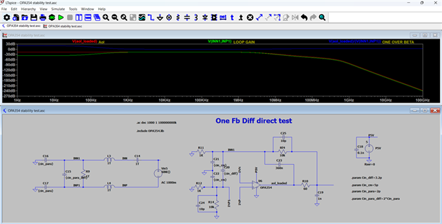

I am trying to run a stability simulation in LTspice for the OPA354 differential amplifier, following the method shown in TI’s training presentations. The goal is to extract the phase margin by plotting Aol, 1/β, and loop gain.
Here are the details:
  • Setup:
    • LTspice stability testbench for OPA354 in differential configuration.
    • Measurement of Aol, 1/β, and loop gain as in TI training examples.
  • Expectation:
    • Aol should resemble the open-loop gain curve from the datasheet (≈120 dB at low frequency).
    • Aol and 1/β should intersect at some frequency to allow phase margin analysis.
  • Actual result:
    • Simulated Aol is about –16 dB (much lower than expected).
    • Because Aol is so low, it never intersects with the 1/β curve at any frequency.
    • If I replace only the op amp model (e.g., with OP777), the simulation looks correct and behaves as expected.
  • Question / Request:
    • Why does the OPA354 model produce such a low (and incorrect) AOL in this LTspice setup?
    • Is there something specific about the OPA354 macromodel or setup that I need to adjust?
    • Could you please correct what is wrong and provide me with a working simulation example where the phase margin (PM) can be clearly extracted?
I have also attached my LTspice simulation files (schematic and models) so you can reproduce the issue.
