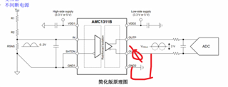

This is Shenzhen FAE Evan, my customer is seeking for a single end output isolation voltage amplifier.
1. Do we have an isolation voltage amplifier can give a single end output without additional OPAMPS?
2. Can I use OUTP and GND2 as single end output directly for AMC1311, any concerns?
  • Hi Evan,
    I will email you offline!
    For #2, yes, they could just use OUTP instead of including an OPAMP if they wanted to use the AMC1311 as a single-ended device. To do this though, we recommend tying OUTN to ground through a 10k resistor for best practice. Please note this will only allow half of the full-scale output range and does not include filtering.
