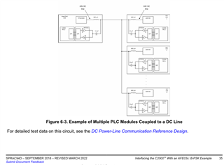

i'm using this BOOSTXL-AFE031-DF1 with LAUNCHXL-F28379D (DAC MODE) for powerline communication. i'm using it over a DC line. i have gone through this also (Interfacing the C2000Tm With an AFE03x: B-FSK Example). i have some questions regarding that.
1. what is the coupling capacitor rating for integrating it to a 28v DC line? is there any formula to find that?
    The standard practice is that you need to have 2X to 3X of overvoltage rating for selecting coupling capacitor for 28Vdc rating. It depending on the application requirement, perhaps low leakage capacitor should be used. So you would need a minimum 50Vdc or higher coupling capacitors for your application. It also depends on the DC line current rating, which you did not specify. If this is low current rating, then regular ceramic capacitor may work. Otherwise, you have to increase the coupling capacitor up to close to 100Vdc rating.
