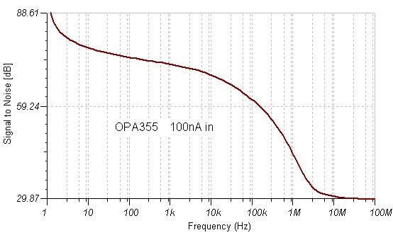

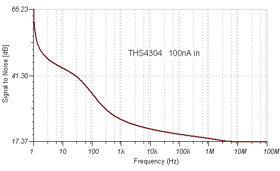

This is for a transimpedance amplifier. I have a modulated signal (~1MHz) with 75% duty cycle. (i.e. 750nsec on, 250off).
We currently have designed OPA355 and it works well in terms of noise etc. except it is not fast enough. If I increase the gain above 200K, the rise time of the opamp violates my 250nsec rise time hard limit. (We have two stages and total of 1.6Meg gain target as we work with a 50nA signal.  We make sure things are low noise and we try to gain as much as possible in the first stage to get better SNR)
So, I like to get another recommendation from TI and other masters in the forum.
My hard requirements are:
- Good gain (400-500K target) in the first stage.
- 250nsec rise time
- Single supply (3.3v preferred but I will take 5V as well)
