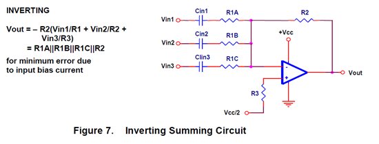

I am following the advice on Application Report SLOA058 Figure 7 to use an OPA340 as a summation circuit.
I am using a Vcc of 5V, R1A = R1B = R2 = 1kOhm (for gain of 1) so R3 = 330Ohms (There is no R1C in my circuit, only two inputs).
I have set up a difference circuit (Figure 8) with no problems, however the summation circuit is giving an unexpected output.

  • Where is the 330 ohm resistor?
  • Hi Neil,
    The app note places it in series with the non-inverting input (R3).
    It may act as a protection to limit input current into the op amp if the non-inverting imput voltage goes above +Vcc. I left it out because I don't see that being an issue and removing it removes a small noise source.

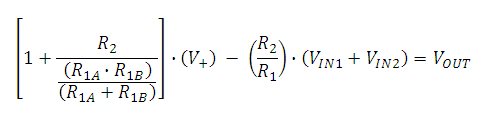

    Now, with that limitation in mind here is what I think is happening. In the equation "-(R2/R1)(Vin1+Vin2) = Vout", you are assuming that V+ is grounded. If V+ is not grounded then the equation becomes:
    Which, for your resistors values of R1A = R1B = R2 = R1 = 1k reduces to:
    Finally, with V+ = 2.5V then the equation is "7.5 - (Vin1+Vin2) = Vout". The summation of Vin1 and Vin2 is subtracted from 7.5V. When Vout is not in the range of 0 to 5V then the op amp output saturates at either rail and the condition V+ = V- is no longer valid. Therefore, Vin1+Vin2 is limited to values of 2.5V to 7.5V.

  • Rob,
    I should of asked you before, are you using the DC coupling capacitors from figure 7 in the Application Report SLOA058?
    I left those out of my analysis, but those will also affect the transfer function. If you do use them then I believe your transfer function simplifies to Vin+ - (Vin1+Vin2) = Vout BUT, they will block DC voltages from VIN1 and VIN2 so that you can only add AC signals.
    Chris

    You are applying voltages to both the inverting and non-inverting terminals of the op amp. In essence you have both an inverting op amp configuration AND a non-inverting op amp configuration together. (Recall, that the gain of an inverting op amp is not the same as a non-inverting op amp).
    When you DO NOT include the AC coupling capacitors, the V+ voltage input to the non-inverting input of the op amp sees a non-inverting amplifier with a gain larger than 1 (=3).
    When you DO include the AC coupling capacitors, you change the feedback impedance ratio so that the gain of the NON-INVERTING amplifier is 1.
    The equation "Vout = 2.5 - (Vin1 + Vin2)" is a simplification of the more general equation for your circuit:
    Vout = [V+ x (non-inverting gain)]  -  [(Vin1 + Vin2) x (inverting gain)]
    ...this is found using superposition.
